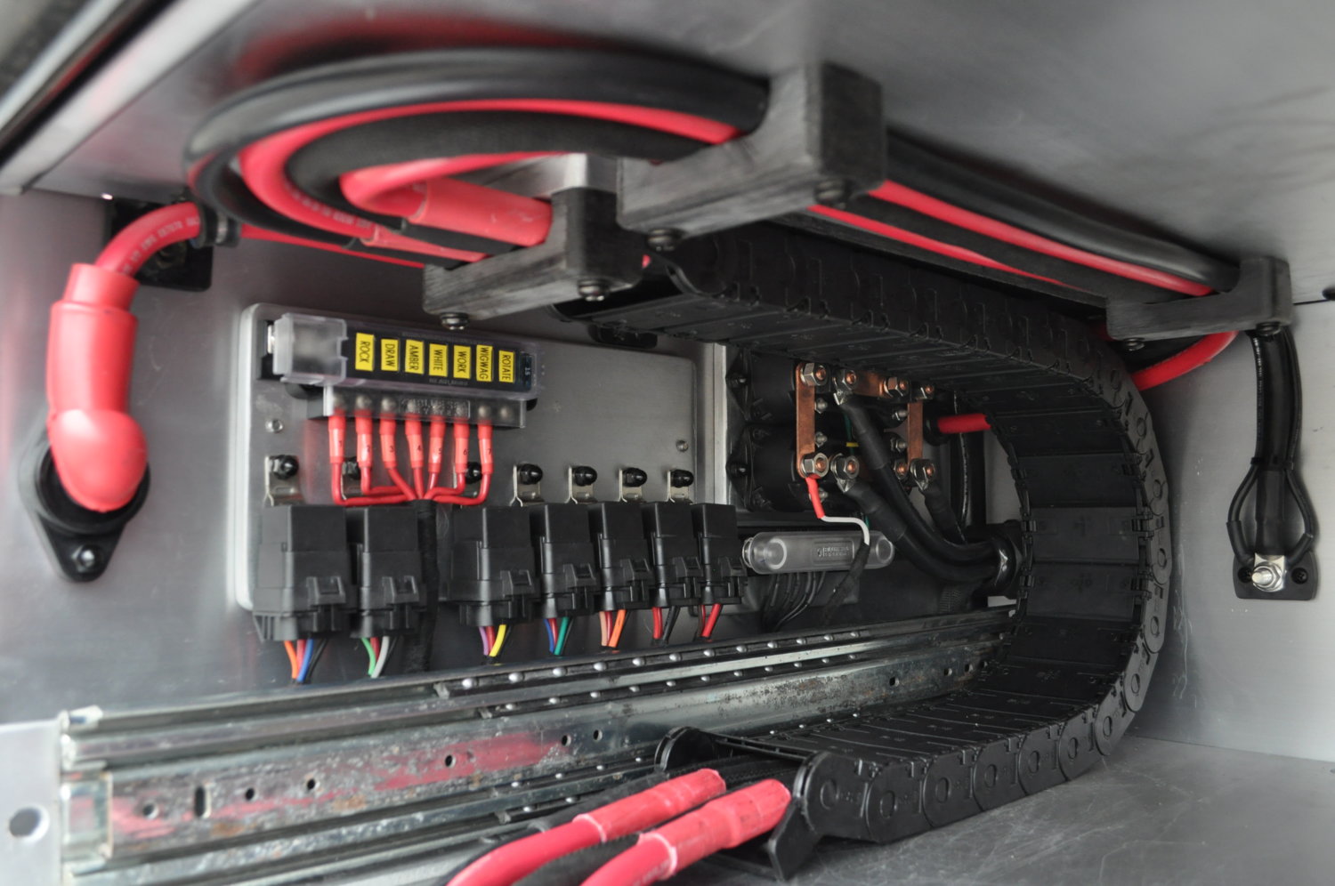

I generally come up with overly convoluted alum or fiberglass solutions unfortunately... :haha: :doah: you either need to put them under/behind something, or hide them in plain sight with an enclosure.. we have some pretty fancy stuff in the marine biz for this stuff... hubbell boxes, IP65 stuff, etc....
here's an oldie but goodie.... ;) some day it'll be back....
full
and here's the relay setup in Mutt's box....
full

good memory @ryoken yeah it was me.. never got around to finishing it...
