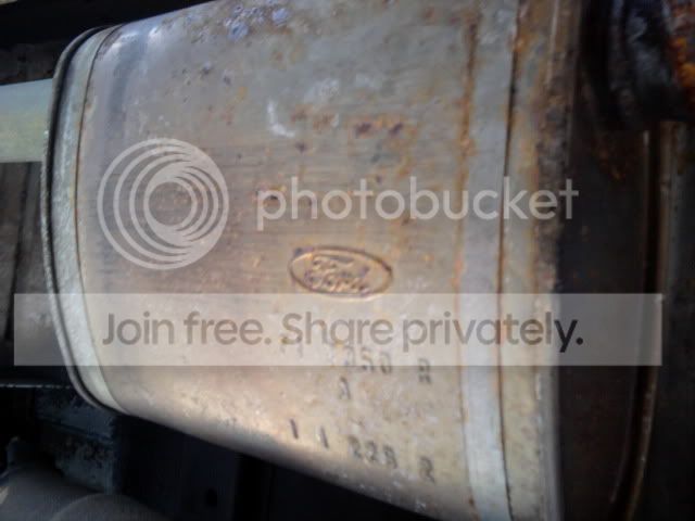

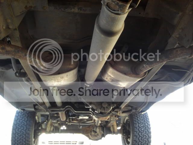

he he,,,, pictures of mufflers, i have an interesting one for ya....
temporary setup, as i had crushed the crossover pipe on the last offroad trip i was on, excessive exhaust backpressure was causing problems with the motor. scrap pipe, some left over mufflers from a Mustang Cobra and this is what we got. :doah: :whistle:
it's ugly, but it works :D
