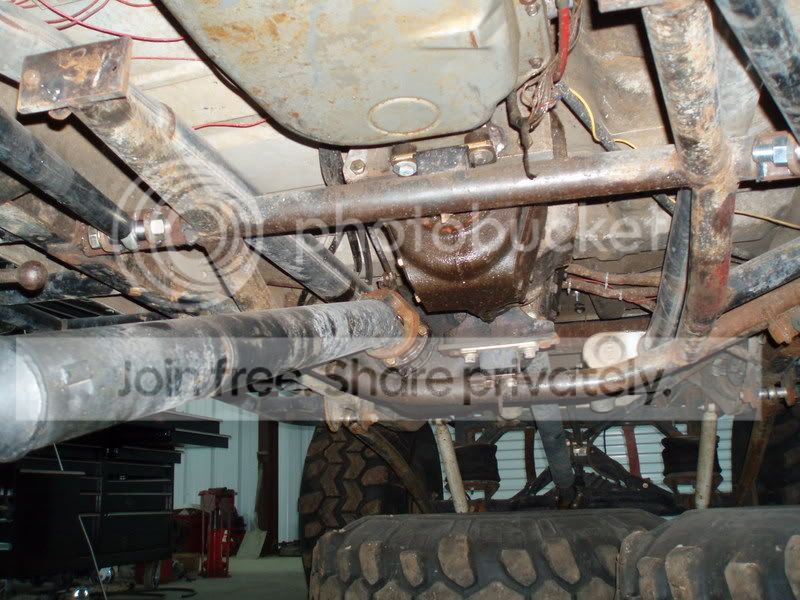

My bud here in town is just a couple weeks away from having his build done. He's running a Toy with dual auto trannys. It's long. I mentioned to him some concern about the second case handling the tork instead of the t-case. We'll see how it holds up once he gets it going. He drives hard so it should be a good test of durability. Has lots of pics showing everything.
http://bb.tennesseeoffroad.com/ubb/ultimatebb.php?ubb=get_topic;f=5;t=000391
I know of a few people who run TH-400s into a SM465s with a married 205 on the 465. One of them is running some 60+ tall rice and cane tires on 2.5 ton Rockwells and a couple are running them on with 1 tons and 16.1 ag tires. The only problem any of them have had is using too low a gear in in the manual tranny and snapping axles. It is a long combination and mounting should take that in to consideration.
