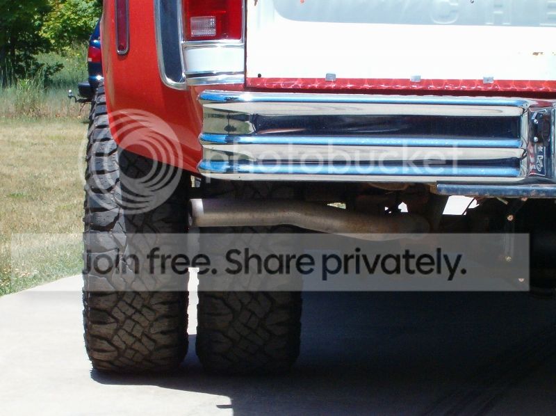

I'm going to put 265/75's on mine....hopefully without issue!
they are wide 265's too. Good year duratrac, seem to be wider than any other 265's I've run across.

265 fit with 2" spacers perfect like factory i have done this before for a guy. and here is the spacers he used. http://www.wheeladapter.com/dually_spacers.php also used his spacers on a f350 and f550 trucks i did .
I should follow up on this, I purchased the LT255/85R16 tires. They fit ok without a spacer, but fully loaded they do rub and will require a spacer to avoid damage.
I should have jumped back in too Kenny...I ended up with a 1.5" spacer on the aluminum Weld's....
