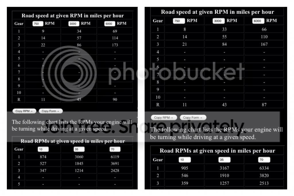

Hypothetical
If you are running a Turbo 350 tranny and 35" tires here are the differences.
3.42 on the left / 3.54 on the right. Driving in a straight line in 4WD with traction the faster pulling front would be trying to drag the rear a bit.

The difference between 4.09 and 4.11 is a whopping 0.49%. That is equivalent to the difference between a 34.8" and 35" tire....which you could easily see just by a small difference in wear, tire pressure, or weight between the front and rear tires.
Back to the OP, you should not have any issues between the 3.42 and 3.54 gears.
