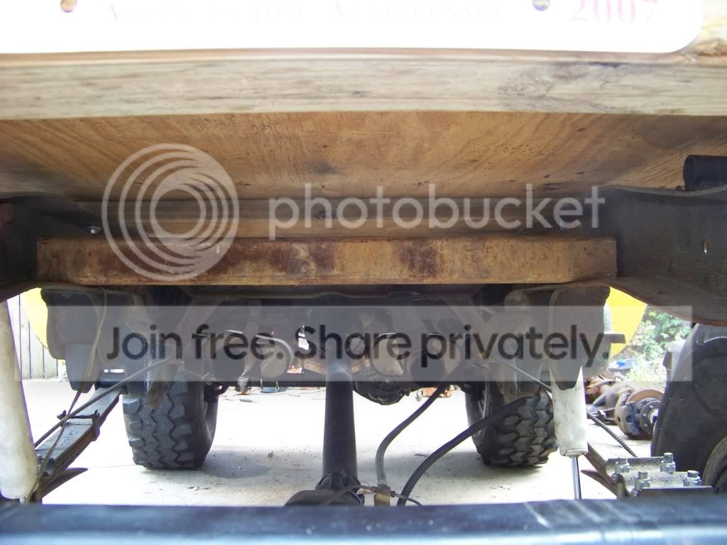

do it.... Both my trucks have turn downs (or 'dumps') out of the muffler, before the axle. No tips to keep clean or get bashed up, and it sounds a bit better - sound reverberates off the ground.
I'll get pics in the morning, show you how it's done.

mine looks exactly like obijuans, and it's good but with the diesel I get some soot build up , nothing major though
