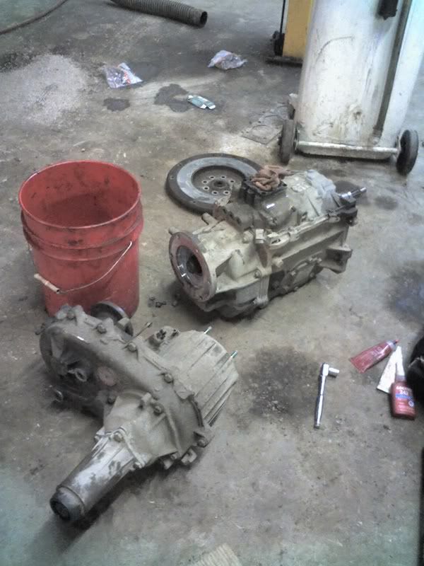

A 32pline 205 will not bolt up because the ZF6 is a 29spline like the Dodge nv4500. An Atlas will bolt up to it though I'm told. I'm in the process of trying to gather the info to get a 205 behind my 01 because I sledpull it and don't much care for the np263.
The ZF6 for behind a 8.1 is the same IIRC but requires a different flywheel.
A nv4500 will bolt up to a D-Max with a custom flywheel and than you can use a gm nv4500 with a D60 swapped in :D.
One guy I know has a D-Max/nv4500/205 with a D60 up front. Not finished but it will be sweet.
Any more questions feel free to ask :D.

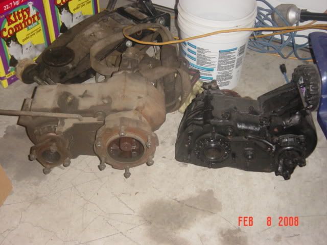

Yes there is. Gen 1 dodge cummins with the getrag 5 speed had a passenger side drop, 29 spline imput.
I also converted a Dodge NP241 passenger side drop to 29 spline with a input shaft out of a LH drop 241
10-4 on that.......I have a passenger drop 29 spline 205 in my garage. uses a 29 spline coupler just like the 465/205........this will bolt directly to the back of a NV4500.
rare though, only application was as said 1st gen dodge behind the 5 spd getrag.
Hahaha.......great minds think alike! Waaaaaay ahead of you brother........
Although I have no idea what the back of a Gm ZF6 look like....this is on the back of a NV5600 which is identical to the NV4500
this is my ford 205 thats going to get the Dodge input and an advance adapter............to replace the 241 in my Dodge when the 'ol cummins grenades it :D
No,but there is a Ford 31spline and a Dodge input could be used. Not sure the Dodge 205 has a male or female input. Anyone have one handy??
Like blaker said, cummins dodges with the getrag is where to look. They have a male input gear, with a sleeve like the 10 spline 465 setup.
