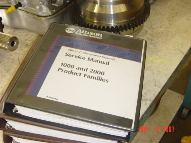

for sticks and giggles this is what an 1000 Series Allison looks like for thsoe that have never seen one insideout.............
