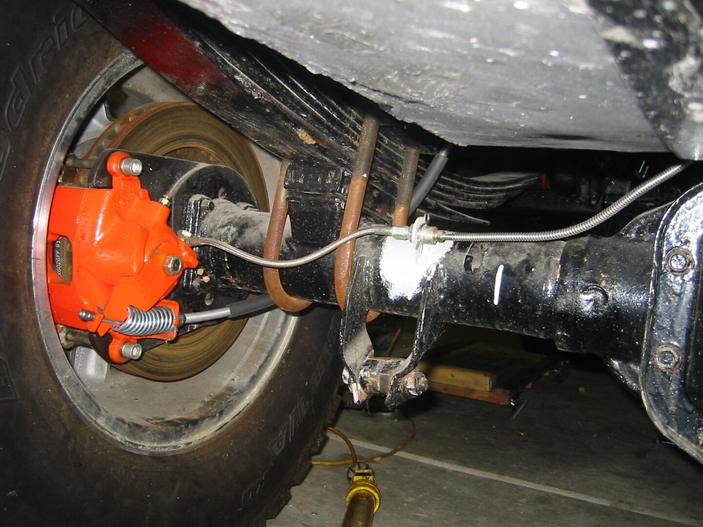

Here's mine.
I had http://www.inlinetube.com make a set of SS cables. They'll make anything, just tell them what ends you want and the length. (Ie, brake end is 1978 Eldorado rear caliper, front is 1973 K5 Blazer, length is xx")
Great company to work with, very friendly, fast and excellent quality cables.
Well,that was a drawback, but here in the rustbelt, it's a no-brainer.
The SS ones are about $90/cable individually.Three required, plus the plain equalizer cable and little associated clips and hardware..
Whole set, with everything needed was $330. Only $30 more for the custom work than a 'production' cable they have.
