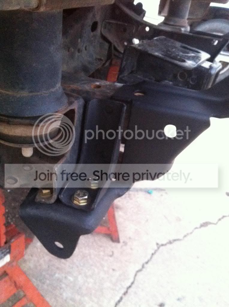

You are right Chris, I have no experience with line locks. I have however read it many times. I also would rather have a mechanical system rather then rely on line locks but, I am just an end user, no pro like you. I do want to say, on another note, that I am in love with my brand new installed front 4 link kit from ORD. I am sure there's no other wagon like mine with this kit on it. Also the cross over steering is awesome. You will see it soon in my favorite 4 wheel mag. Thanks
