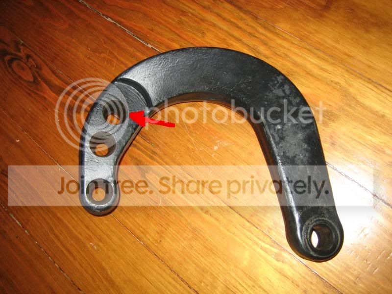

Yeah, with an old steering arm it can take some real beating with a hammer. When I first looked at it, I thought there were lock washers or something under those nuts while they are infact slotted tapered sleeves (the best way I can describe them) that hold the steering arm tightly to the studs. Look at the pic I posted and you will see how the sleeves fit in the tapered holes in the steering arm. You have to beat the steering arm until you see those sleeves start to get loose and then it's best to pull those out as soon as they are loose enough. Once those are off, the steering arm should slide right off those studs.

On top of the stock arm, toward the steering box, there should be a string of numbers casted in the metal. Take a BFH and hit it on those numbers. Seems to be a sweet spot for getting the arms to come off.
