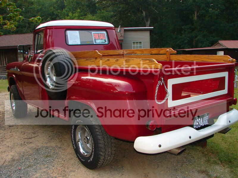

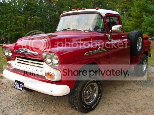

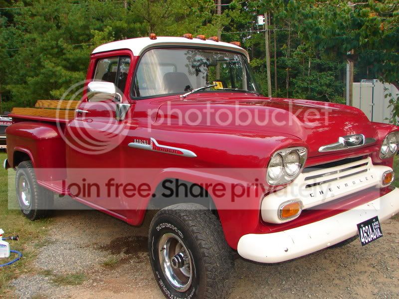

not to change the subject but 58 apache lets see a pic of your truck !!! i myself have a 58 and 57 . my 57 sits on a 70s chevy frame with 40 inch boggers . my 58 is taken apart for now . but i always love to see other peoples :laugh:
as it sits now... 406sbc 428hp @5000 525 tq @ 3800 built manual/auto th350 np208 on 31's just got the 14bff 4.56 lookin for a 60 but think im gonna do a 8 lug conversion for now. researchin lift. think im goin with a tuff country 6" all spring. i have 3" of body to clear bell housing(no choice) i have 37x13.5x16 baja claw radials on pro comp 7089 black alloys.... enjoy!!!

sorry took me a sec to notice the new foemat of things . :mad: whats up with that anyway i like the old way better. anyway nice truck :D
ive ride'n in that truck, that sucker flies with that 406sbc. its going to be a killer machine once its finally got the 37s on it!
muddybuddy, with your help hopefully the 37's arnt that far off...still gotta get front 8 lug conversion. and i gotta find the best price on tuff country soft ride 6". i still want that seat!!
pretty cool. got a 57 3/4 ton i've had for about 15 years. used to be my tow vehicle until I got my diesel truck. going to put the cab on a 74 chevy 1ton CC pretty soon.
Sweet truck man! I love the old apache trucks. What style.
