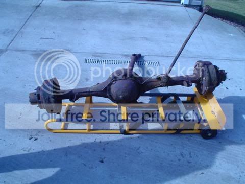

Here is a pic of mine, it was under a '65 C20 so that's why it has a trac bar and trailing arm mounts under the axletubes vs. leaf perches on top. That truck came from the factory with 4.57 gears and a No-Spin (Detroit). I got a 3rd with 5.14's from a motorhome that I'm gonna use.
