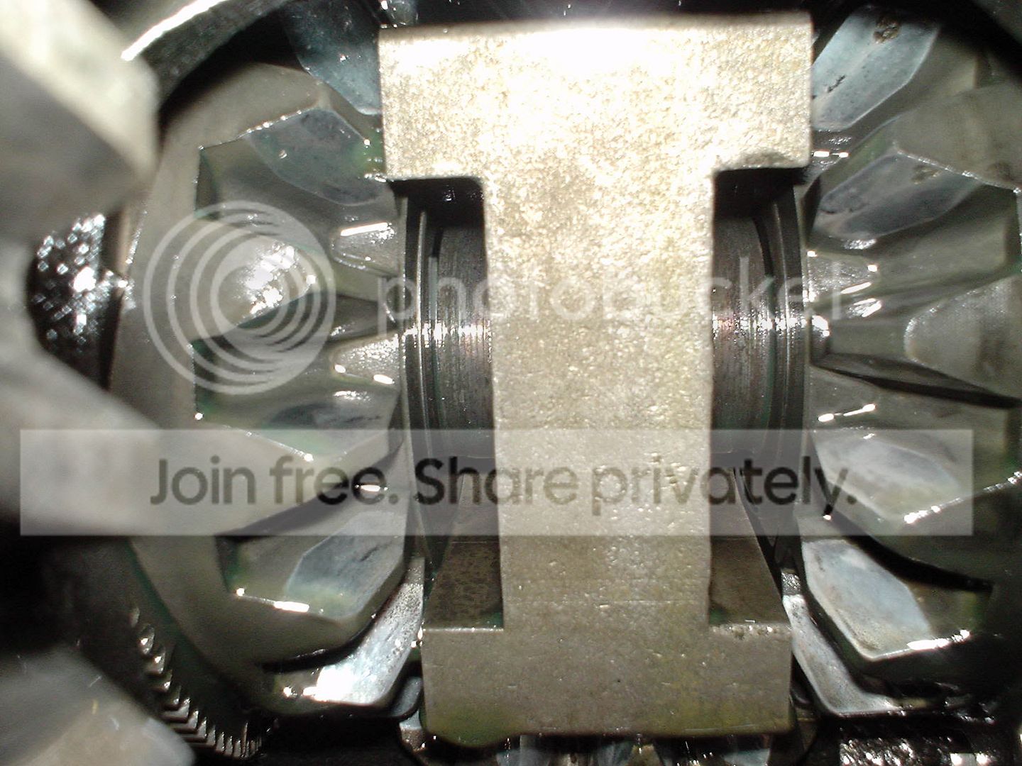

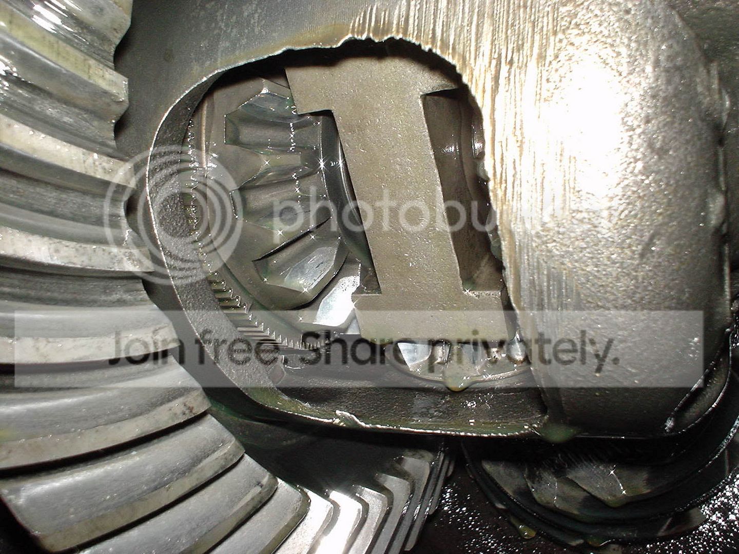

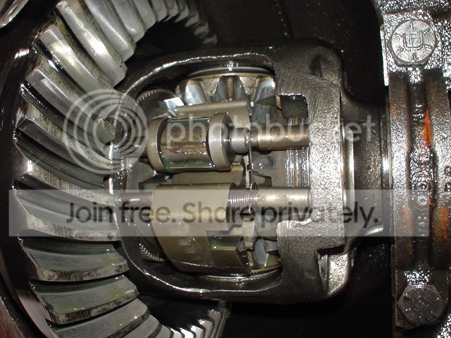

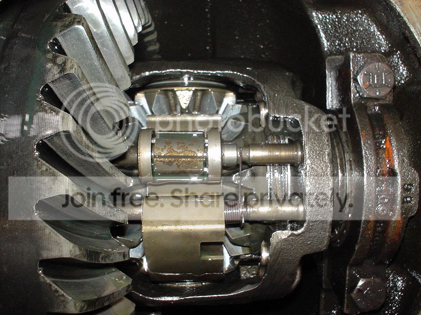

How can you tell if your ten bolt differential is a eaton locking differential or a normal differential?
There have been posts about jacking the rear end up and spinning the tires this way and that. Most positive identification will be by taking the rear diff cover off, and posting a picture of the thing.
-- A
here are some pics
Well somebody'll post up that knows 10-bolts (I'm most familiar with the 14) but all that spring crap in the middle sure looks like a locker of some flavour to me. I'd say it's definitely not open... past that, WHAT locker it is, you'll hafta wait for someone else.
