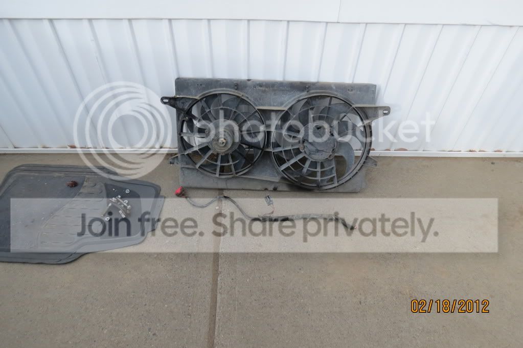

That should be it, here is a shot of the one I just picked up.
Cool. Is there generally no issue clearing A/C and trans cooler lines and stuff?
I see that ebay one is listed at $92 right now. unless you feel like you have to have new, get one from a junk yard. I picked mine up for $20. windstars aren't exactly rare. :D
