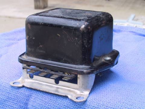

Yep, grounds. Make sure the voltage reg has a good ground. If its in the alt. make sure its grounded. Don't assume because its bolted tight that its making a good connection. For a quick test, run a 10 ga or so wire from the alt body to the neg. post of the bat and see if it settles down. This is more common with remote regs, but the built in ones do it too.
inside a black box
, like this
I know thats the external regulator but where does an 81-87 chevy truck have it?? in the my alt has 3 wires but ive never seen the regulator nor out or inside the cab
Probably doesn't have an external on that year, but I didn't know the year at first. If it does have one, it usually on the fenderwell somewhere.
Either way, check the ground on the alt.
Your truck shouldn't have an external reg.
