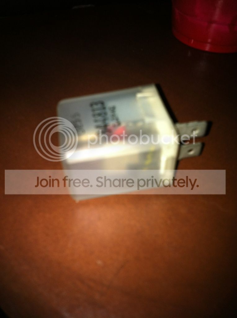

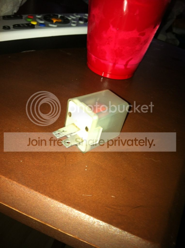

Also. Wtf is this? Would it be my problem?
Has these numbers on
0255
344813
2.294Q
And by the blades is has a
1 pm
2
3
Made in canadia eh.
Please help
That looks like a flasher, so doubtful that it's your problem.

I don't think that's a flasher tho. I thought the two round silver things were for the flashers? Oh he'll who knows. Need to just replace the harness.
Ah see that's half what I expected to hear was toasted wires.
In theory. How should one attach to the fuse block to get switched power while still getting a fuse? I have no problem doing it right.
You're right, the round ones should be flashers. That must be a relay, but I couldn't tell you for what:dunno: i'm no electrical wiz, so do totally quote me on the possibility of burnt wires, but that's what I would think would be the culprit. I assume you'd need to tap into fused power from inside the fuse block, or do it the way it was but run an inline fuse to the accessory.

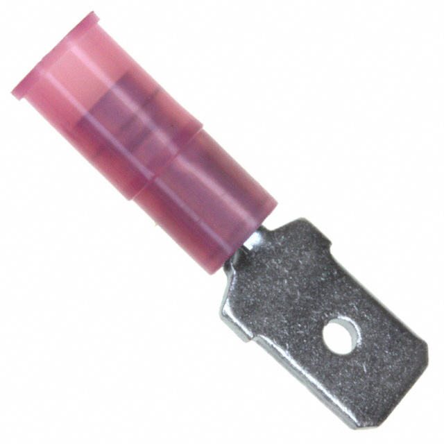

This is what I use as a temporary fix
I use these as a temporary fix. If I need anything else for regular duty I install relays.
They work wonders until you blow the main fuse, but in a perfect world an inline fuse would be the next thing attached to the brass clip.
