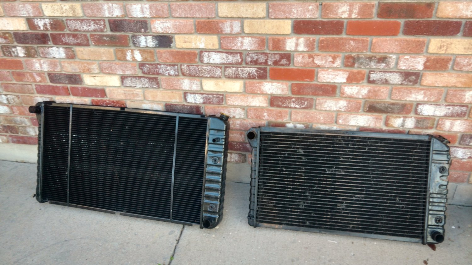

I'd be willing to ship them his way, or to @Gravel Maker , or @cybrfire , @Stephen .
I have no plans to run these. Was walking a yard a few week back and stumbled across them, only picked them up after reading how @ZooMad75 and @mrk5 and a few others were having troble finding them...
I wonder if @Deuling could copy / reproduce those since they're so hard to find?
I suggested that too, but it didn't bring a lot of interest.
The brackets are out there. But you need the 6.2 specific fan shroud to go along with the brackets, radiator and the separate top plate. Best to swipe all the parts from the same place if you can.
