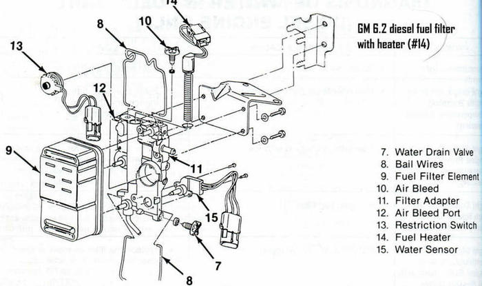

o.k., I did some snooping around & found this
and this
I have no idea where your plug goes.
