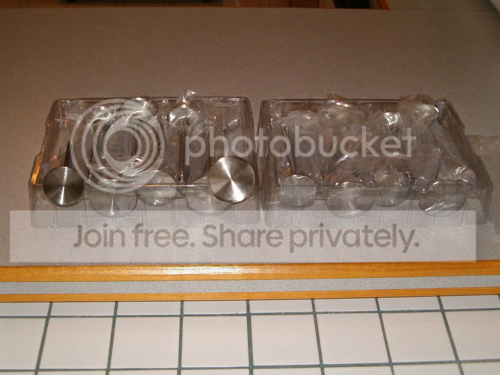

The new valve set:
A link to the manufacturer:
http://cgi.ebay.com/ebaymotors/ws/e...0364370249&viewitem=&sspagename=STRK:MEWNX:IT
YES! We will be getting a spring set from Comp Cams, Jerry said he wants to put a set of double springs on it, I think because of the valve train weight? (that's why I'm leaving this up to him) They should still be stock diameter, and they have the rotator eliminator too! He wants to check the valves out before deciding on the spring set.
