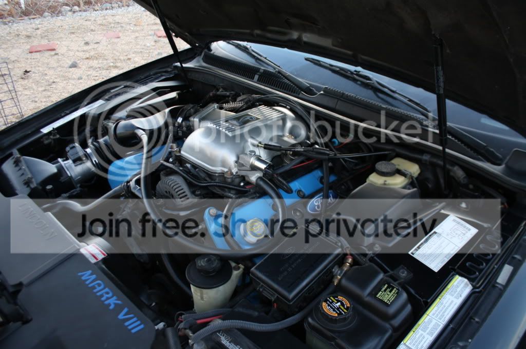

Not sure about the part #'s, just saw some edelbrock stuff at autozone the other day and thought it would look nice. They were cheap too, like $30 for covers and 30 for cleaner. I am used to working with newer engines like my lincoln I changed to a cobra engine last year. Nothing wrong with wanting it to look good to. ;)
