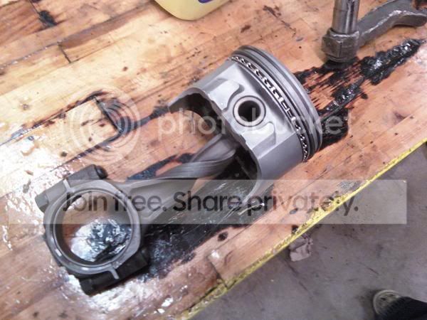

okay I pulled my oil pan and guess what.. GUESS WHAT!?!?!?
silver oil and shavings on the bottom of my pan.. so anyone got a gallon of gas to spare. and some matches?..
That don't sound good. Can you tell where its from?
I can't think of a good place for it to be coming from, but some are worse than others.
it looks like it's from the cylinder Right above the oil pump. Oh well time to get a new motor. :(

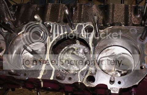

just hope it doesn't come apart looking like this :p:

Any idea what the failure was? See any scoring on the cylinder walls like a cracked ring?
If you tear it down or figure it out anytime soon, let us know. I, for one, am curious.
Combination of really bad detonation while going around a corner too fast.......
