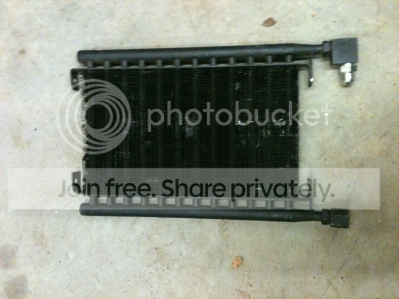

I've got an early tube & fin style (70's-ish) engine oil cooler I'd like to use for a p/s cooler - any reason I shouldn't?
Assuming I'm careful about bleeding the system, any reason I can mount it horizontally?
Just ripped one of these off the new truggy truck. Was wondering if itd be useful anywhere. Subd :waytogo:

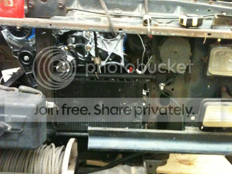

I have a remote resevoir that will mount above the pump. I plan on mounting it low like in the picture which is relatively even with the pump itself.

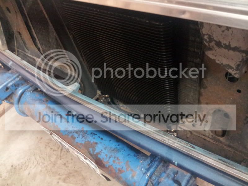

Should be fine. I used a B&M and mounted it like this with no problems.
The one on the right is PS
also went B&M. i used the factory original mounting brackets by bending them a little and drilling larger holes in the B&M cooler. 1/2 hose, clamps, and barb fitting connect it all together. hope it does not leak.
