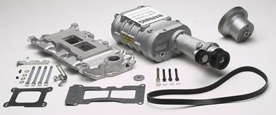

what about slapping one of these on there :D. kill two birds with one stone sick power gain and higher compression (boost). 1,829$ 142 blower
