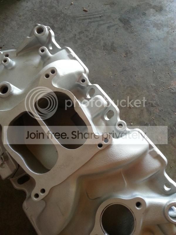

I've figured out so far that my '83 spreadbore manifold won't bolt to the late '87-'95 style heads but I've found an intake manifold locally that should work. They guys says it is a knock off edelbrock (has no brand on it) with slotted bolt holes so it can bolt to the later heads but it is setup for a spreadbore quadrajet. Does this seem like an okay solution to get my quadrajet on top of everything? Should I consider using spreadbore to squarebore adapter instead and running a real manifold? If I go with the no brand slotted manifold what kind of gaskets should I get? I think the "no name" manifold may be a Professional Products manifold.

I ended up picking up this intake manifold from craigslist:
It looks like a professional products intake manifold or possibly a knock off. I've ordered a set of the angled adapter bushings so that the manifold will seal well with the later style heads.
