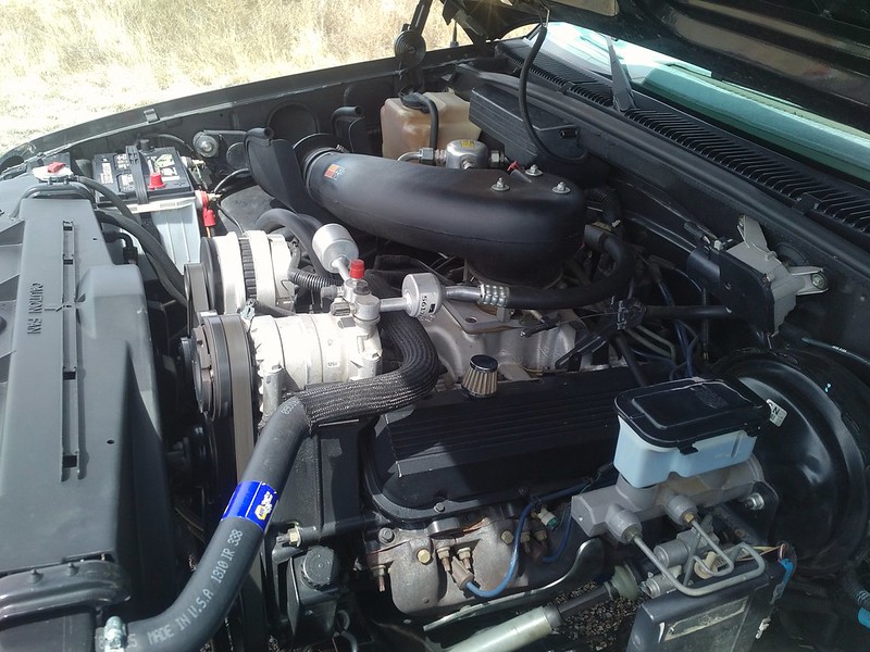

1996 to 2000 Vortec L29 454’s will accept any old carbureted/TBI BBC intake like any other old big block, unlike the Vortec small blocks where the intake bolts were fashioned differently. Hell, I have an Edelbrock carbureted intake on a 454HO with L29 heads. The biggest difference is the L29 heads do not have an exhaust crossover through the intake. Not really much of a big deal and actually one less place for the intake to leak. The intake ports are bigger on the L29 as well where the TBI intake won’t match up exactly but you’ll never know the difference. If it was the other way around where the head ports were smaller would be an issue, not so much when it is the other way around. Slap your TBI intake on the L29 and go. The flywheel will probably be different but the starter will work but you may need different bolts. I can’t remember if the blocks on the L29’s were standard or Metric. I doubt there would be any PROM tuning that would need to be done. The flywheel I used on mine was a 14096987. 454's are EXTERNALLY! balanced but there could be difference between your flywheel and the L29 flywheel due to the later one piece rear main seal.
Same engine as above when it was in my K10 with MPFI before I did the 8.1 swap. I used an Edelbrock intake I had laying around in order to keep TBI on the truck above.
