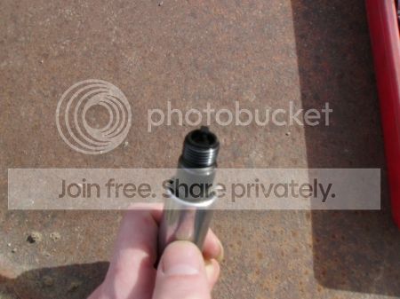

I pulled the plugs on my 468bbc and plug #'s 1,3,5,2,4,6 all look like they have more carbon build up than normal. To me they look like spark plugs with high miles. The motor has about 20 or so miles on it and everything is new. Is this normal and part of the motor break in procedure or is there something amiss?
I would expect some discoloring while the rings seat... but not carbon build up..
Is it smoking out of the exhaust?
It would take a lot of burnt oil to carbon up a set of plugs in 20 miles.. :dunno:

you answered your own question.. it's not carbon, it's oil fouled...
On all plugs? The rings didn't give out until yesterday. Don't see how 2-3 minutes of running it would foul all the plugs like that?
I'm asking this mainly to see if I need to worry about the heads or not. At this point I no longer trust the builder and am wondering if he didn't do something right in the rebuild. Or it could just be the rings?
the rings where failing prior.. just cause you saw smoke yesterday doesn't mean the plugs hadn't been burning it for awhile... rings don't just "fail" unless they crack... it's always somewhat of a progression varying from yr's to weeks depending on the issue...
in other words, it's VERY difficult for carbon to build up on a plug.. take a pic of said plugs..

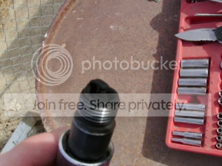

The first pic is the #1 plug, 2nd pic #3 plug, they pretty much all look like these except #'s 5,7 and 8. Sorry about the size, trying to do anything on win8 sucks.

All that time sitting..... there is good chance the cylinders rusted and wiped out the rings when you fired it back up.....
At this point,,, If it were me,,,I would pull the motor...tear it down...see what damage is done.
Mic the block and pistons.... If all good, get it honed,, clean up the pistons and get a fresh set of rings, bearings and gasket set.
Put it back together and you are only out a few bucks....
It doesn't sound like what you have now is going to get any better at this point....
eh, could be really rich too.. what's the induction?
ok, just read the follow up.. yeah, you should be doing a comp, or better yet, leakdown test at this point.. tho as WW pointed out, your gonna be tearing it apart anyway..
