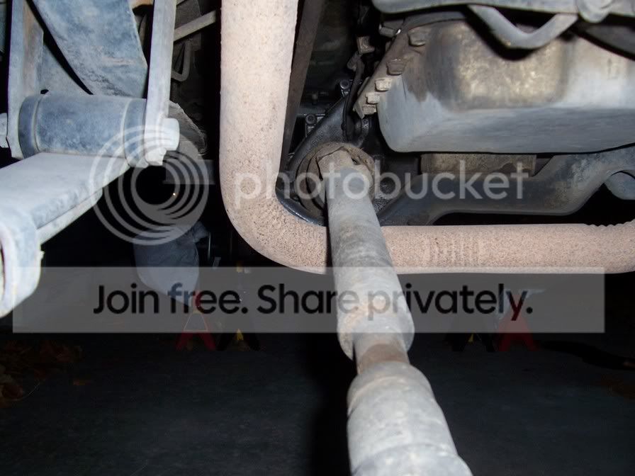

I am in the progress of installing 4" springs and a Dana 60 in the front of my K5 and when I disconnected the front driveshaft it had sprung the crossover down so now with the shaft resting on the exhaust and the stock springs at full droop the yoke is about 3 inches lower than the shaft joint. How have you guys corrected this issue. I think it will be closer to 4-5 inches off when I get the lift and new axle in. I would like to not make the exhaust lower and going duals is not an option (Cali smog nazis). Is it possible to run the D-shaft below the exhaust or is their not enough room. Any help is appreciated.

The only problem I had was the D-L hitting the crossmember and I clearanced that with a grinder. You do not need dual's.
ur having problems with 4" springs????? usually u dont have problems til at least 6". for mine, i cut the y pipe and put about 1" extensions and rewelded it. fixed clearance issues

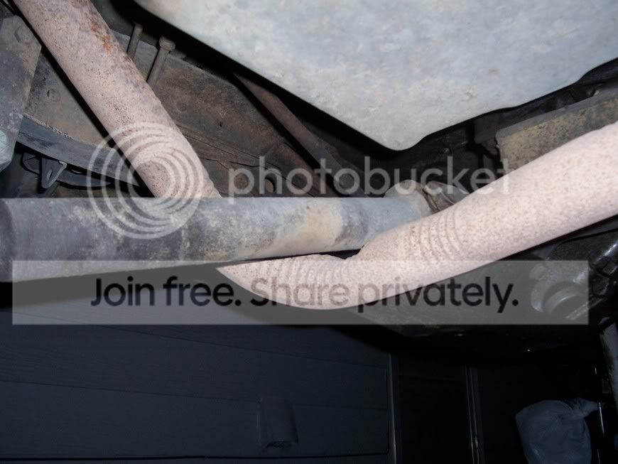

Put the crosover behind the transfer case like so:
Mine had that problem too. I cut the center of the crossover out. Then clamped on a flexy pipe and pushed it towards the crossmember out of the way. I am going to get a 2wd Y pipe so it goes over my DS since my Y doesnt fit edlecrap headers.
Mine looks alot like this it is just tucked closer to the t-case and goes right under the yoke into the cross over into single 3"
I think I have this problem because my exhaust likes to run into rocks:doah: . I also do not want to do the crossover behind the tcase because of smog issues same reason for not going true duals.:D I might try to "clearance" the crossover to allow my Driveline to fit.
