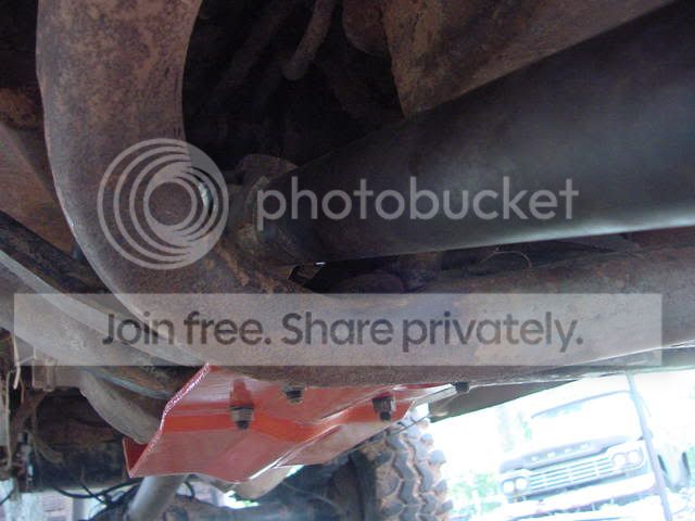

my front shaft is rubbing the stock exhaust crossover.. I have single exhaust.
Who all has modified it and how? Are there any parts store pieces of prebent pipe that I could work with? I've tried prying and it just goes right back into place, and I sure don't wanna rip off the studs on my exhaust manifolds.. I thought of prying and getting somebody to pring an oxyacetaline torch over and getting it nice and orange.. but I would rather not have to fool with that.
I'm almost to the point of running a small piece of angle iron with a hole drilled in it over the top of the pipe, and bolting it to the skid place, to kind of permanently hold my pipe down for me :crazy: Tomorrow I'm gonna battle the exhaust, so pics of how you've modified the exhaust to clear the shaft are very welcome!!! :bow: :bow:

I got an elbow from Autozone for about $3. Cut the pipe shorter than the elbow, spread the pipe a little, insert the elbow and weld it in. You then have that extra inch or so that you need to clear the shaft.
could you snap a pic of it sometime?
diesel4me= that sounds like a tool I need to look for!!
I've used a prybar and BFH, now its clearing by 1", but I dunno if that will be enough
here's what I've done so far just using a big ol pry bar and BFH
