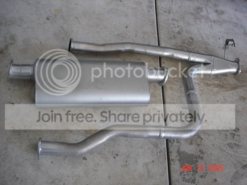

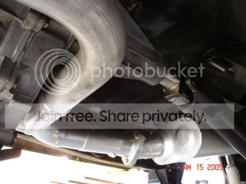

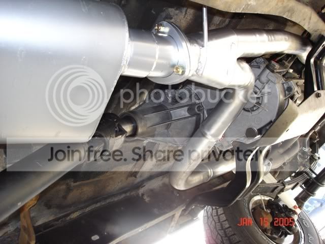

Your best bet is a single 3" exhaust with a hi-flo cat and a performance muffler of some kind. You can have the shop tuck the passenger pipe up high and in front of the trans pan and over to a Y on the driver side. This is how mine is set-up and it works very well and is WAAAY out of harms way.

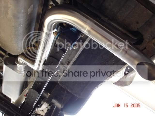

When I installed my edlelcrap headers and a hiflo cat, I had a local shop build mine
In response to the two 4 bangers under the hood, no, it won't sound like that. I actually like the sounds of true dual over the catback systems of today. No, an H or X pipe won't lose effectiveness back there. It's just there to help balance back pressure. Granted, putting an H under the bumper is pretty useless, but close to the muffler isn't so bad. An H right in front of the mufflers would be best.

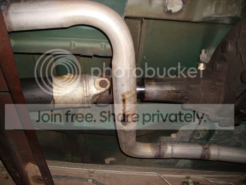

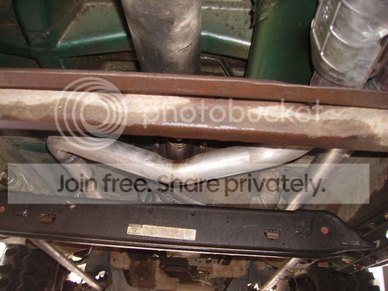

different truck but same concept...
then it goes into the xpipe seen here... all 2.5" stuff oh yea and i have some high flow cats welded to the front of the xpipe now

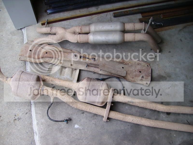

Speak of the devil- I just placed an order for a new exhaust from summit yesterday. My old one rusted through (at the header collector) and the muffler fell off too. Not even enough metal left for me to weld it back together.
