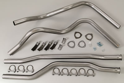

What kind of exhaust kit could I get for this? Or do I still have to have a shop make something up?
Single or duals?
Thermal coated with the 3/8 flange and you can't go wrong. Been running mine for 3 years and they still look great, no rust. The 3/8 flange stays nice and tight, no leaks. I bought the offset extensions which connect to the ball flange and went up and over the cross member with them. Thus i'm running true duals.
