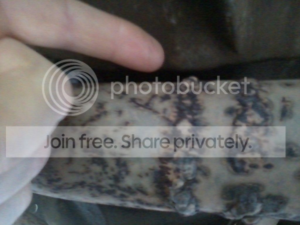

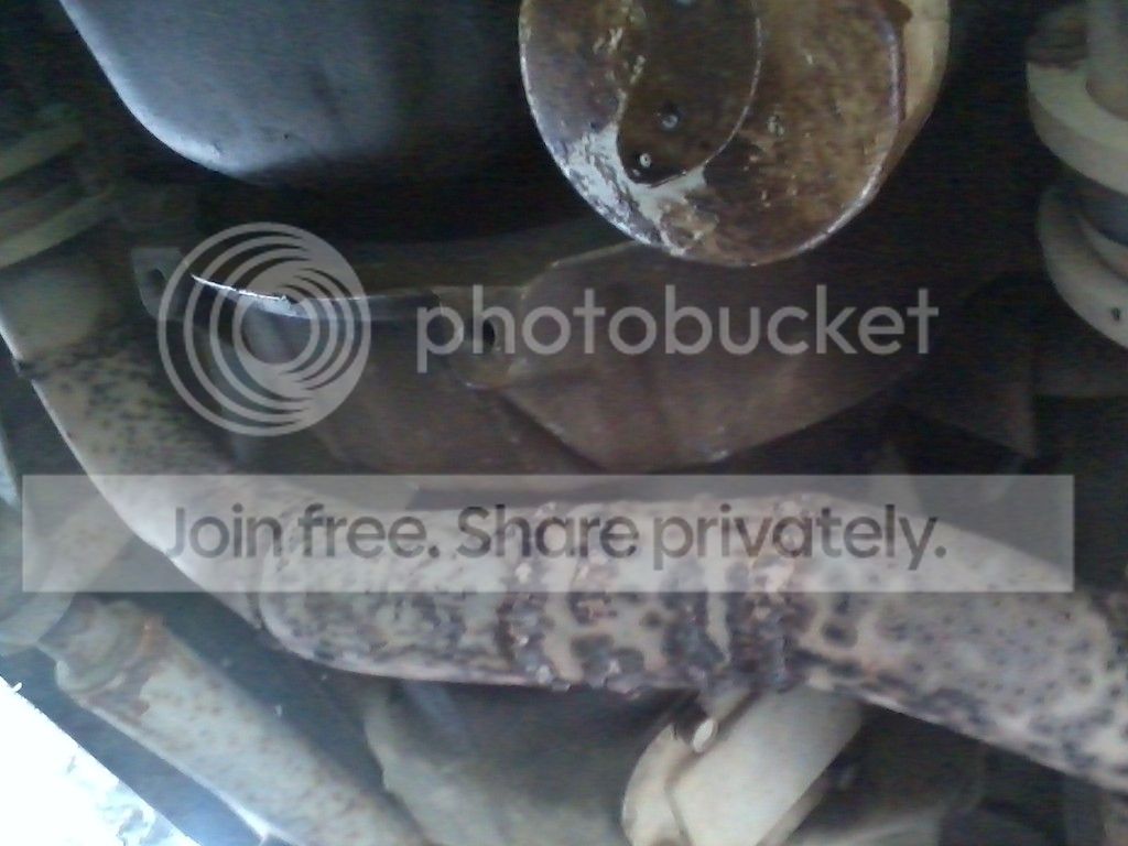

This is why they use aluminized pipe for exhaust lol. Only about 6 months on this. But I did it on the cheap to get me by for a couple more years until I can swap bodies and do full on stainless, and learn how to make this stuff up. I also learned I need a welding helmet that allows me to see what I'm doing. :(
It was hot, I wasn't going to touch the pipe. But it gives you an idea of how much clearance there is between the bellhousing and pipe. No contact, no heat issues with the aluminum.
