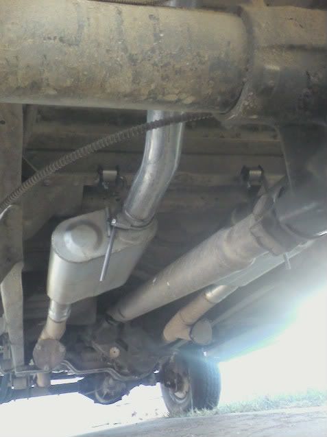

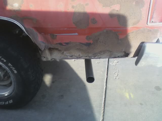

I just cut it, and spliced in wire with heat shrink butt connectors. I took mine to an exhaust shop and had them just bend it up for me. Mine is 2.5" from the collectors back. I have 3" dual cutouts behind the transfer case, and Flowmaster mufflers.
Martin
I had smashed the case on one of my cheapo mufflers on it, so I found these used 2.5" Flowmasters from a friend for $20.
I did just dump the exhaust at the rear axle previously, but it was louder inside than I liked, so I installed tail pipes as well.

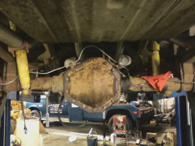

Here is another pic from when I swapped in the 14bff.
I have a lot of pictures in my build thread, but I don't know if any of them would be of use to you.
