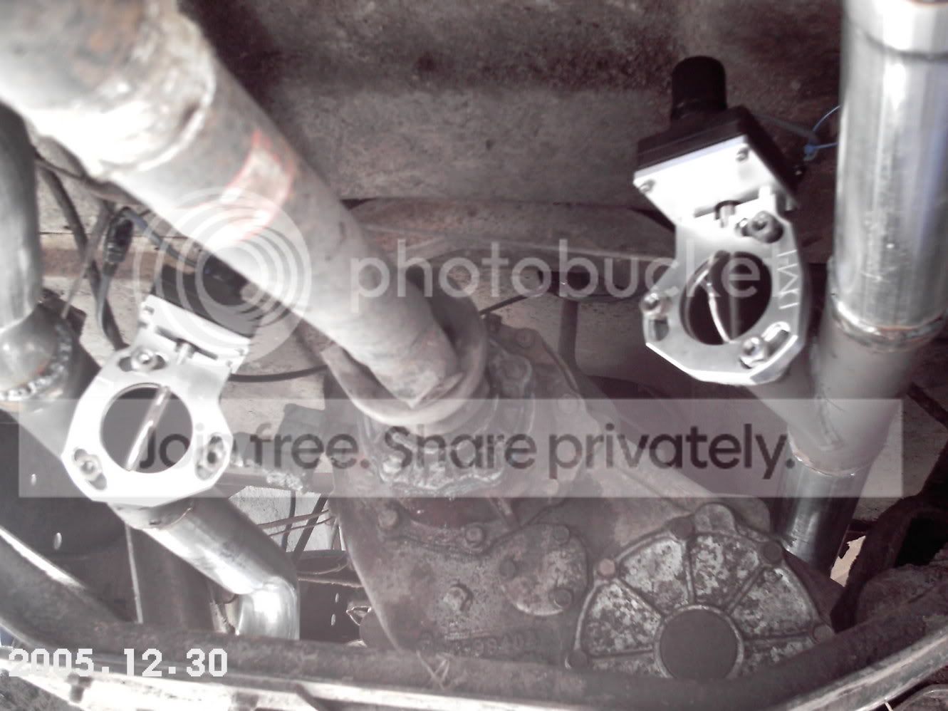

DONT USE CABLE ONES!!!! they leak, rattle, and all around suck. I just put on a set of duel DMH and I love them. I have no leaks and when they are open the fumes arnt bad. Plus there is nothing cooler than opening them up at a stop light!
Check them out
oh my god i need these on my truck how much am i looking at and would a shop do the work? it would be on my 89 blazer that i want duels with my heddman hedders and a 2.5 inch pipe
a set like mine was around 4 hundred. There are cheaper ones but they tend to leak. Its alot of money but well worth it. (400 bucks or your 1 christmas present for the year!) I had my local shop weld them in. I did all the electronics my self it was very easy. Check out summit racing for DMH exhaust cut outs. Expect around 400 for the duel cut outs w/ the dump pipes that need to be welded in. I have a video if I can figure out how to send it???????? Keep in mind this is not for horsepower. Unless you have a high compression engine these will not help hp because of the back pressure needed at low end range. However its loud and cool as hell!
