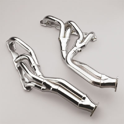

Summit says the tri-y's are available with air injection hookups. I believe that I also need cats with an air tube, although I haven't looked under the truck yet, is this true?.

I'm pretty sure these are the ones I bought, has air stuff tubes and 02 sensor bung. Headman I don't think dual exahust matters in any of these counties. I think as long as you have muffler and cat on both sides your fine. /forums/images/graemlins/thumb.gif What exhaust shop did you call? /forums/images/graemlins/dunno.gif
I am running the Edel Tes system into single 3" exhaust and a 70 series flowmaster. It flows and sounds good. The TES system will bolt right up to your stock exhaust with no modification. The Flomaster 70 series muff for your application will replace your stock muff it is exaxtly the same size. Either that or get a Cat back system. I have installed a few of these on Chev trucks and they are an easy bolt on. I would get rid of the stock Cat. They dont flow well. Get a high flow cat like a Catco or something. Besides the stock Cat gets plugged up after 60 or 70 thousand miles. If yours has more miles on it it is due for replacement.

It looks like you may be on the right track. I just called the muffler shop and asked how much it would be to install everything except the headers (I have to do something) and they told me $850! Add the price of the headers and I'm looking at $1150-$1250. I wasn't expecting this to be cheap, but I wanted to keep it at a thousand tops. I'm going to call some other places, but it looks like at these prices I'll just be upgrading my single with headers(Thorly tri y's are only $330 instead of $400 for the Edel Tes), cat, and muffler. The dual will probably have to wait for the next engine. Doing just the single myself I'm looking at about $600 tops and some money left over to fix miscillaneous crap like window seals, that damn leak somewhere under the driver's side of the dash, and brights. (Or maybe speakers! )
