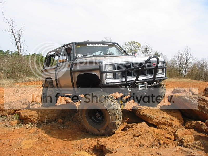

i dig it!
:grin: hey i like that cage. it looks somewhat familiar. thanks, bboy
tailgate
oh and i am running a truck tailgate. bboy
