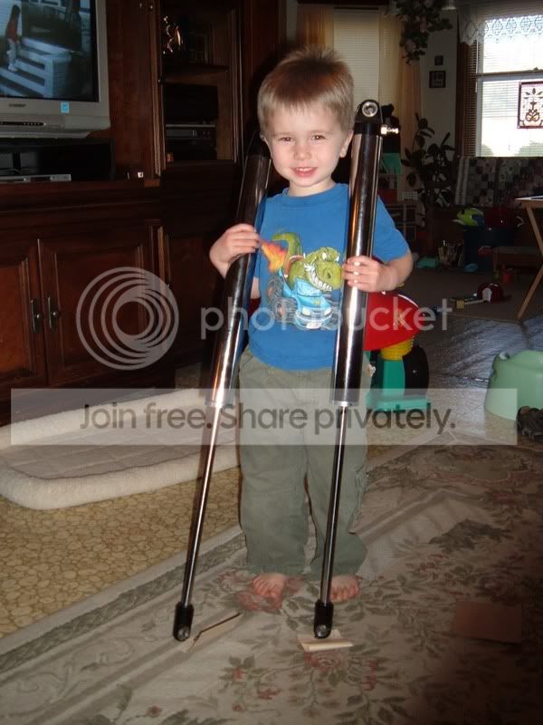

My vote is Doetsch Tech monotube 2.0 smooth bodies. $110ea, custom valved for application, owner rebuildable, optional reservoir. Check the cut sheet below for more info.
I will admit that I haven't run mine down the road yet, but so far I'm very impress with the value.
mrK5, those sound awesome. I love the rebuildablility (is that a word?). I wish you were running them already, so you could give me a first hand account.

I'll be able to give a pretty good assessment because I drove the truck down the road about 1/2 mile Monday WITHOUT shocks. It was crazy the truck was oscillating around just going straight with no bumps. I'm anxious to see now what it'll be like with the shocks installed.
moneypit runs the same Doetsch Techs and likes them.
