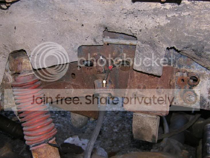

for my six inch lift i just modified the brake brackets where the metal lines meet the rubber lines, just cut it halfway and twist it downward. been running my trucks like this for abou 10 years.
on my SFA s10 build i couldnt get away with it and have to have stainless steal lines made
heres a picture of my brake line bracket on my current truck, the metal line aint touching the frame it just looks that way.
