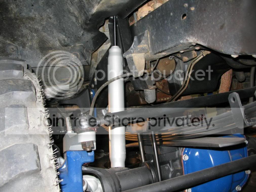

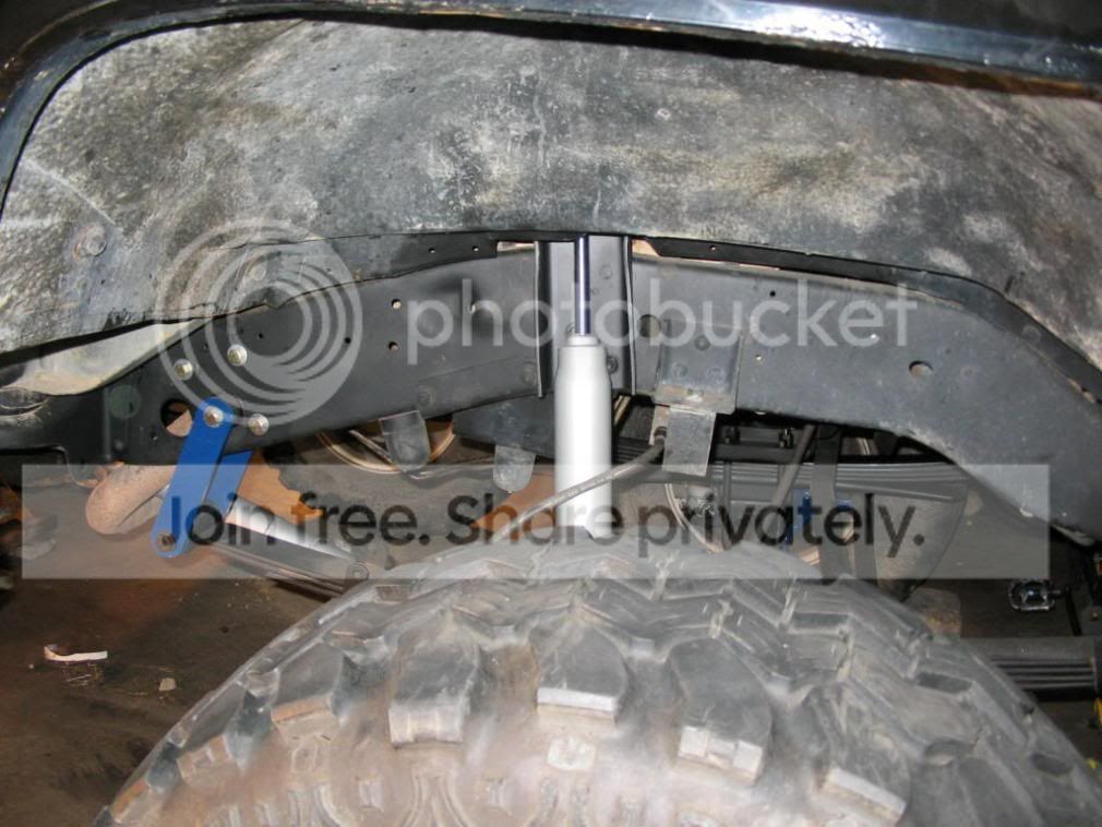

I have 15" shocks and I am pretty sure I set them for 7" up and 8" down. I have about 5" of lift. I actually am going to limit strap the front because i start to bind my u-joint. I actually only use about 5" of up before the springs get flat.
Here is a couple pics of my mount. I used the stock axle locations, and my towers were already cut down so it worked out well.
Im sure someone will have a number to get you close,but its going to vary from truck to truck.
But if you want it to be right for your truck you need to go flex it out and bust out a tape measure.That way you know it will be in the right spot for your truck :D
