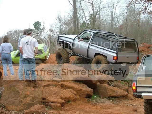

here is my exocage. i haven't wheeled enough yet to know whether i will like it. bboy
Ma, pa i want one of those.
Did you build that? Or do you know somebody who would be me a cage just like that?
Thanks.... i'd like to start out with something like that then add on to it to make it as strong as possible.
BBoy: did you buy that or was that a custom job? I'd be interested in purchasing something like that or that same cage in 3 or 4 months if at alll possible.

Mine should have adequate strength, it goes through the roof and creates a "V" on a new crossmember behind the front seats. There is also a bar that goes through the bedsides from one side to the other. I guess I could have added gussets but I got tired.
I built it myself with the help of friends on a pro-tools 105 that i beefed up. You can do it yourself. Just make some sort of protractor, measure a lot, bend a little at a time, test fit and don't lose patience.
