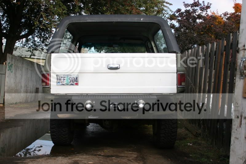

Mounting ... for backup use I prefer them under or in the rear bumper... I wanna see DOWN and OUT, i.e. what I'm about to hit, as well as let people know that the truck is coming at them =))

If I had a roll bar I'd mount it inside under it facing back thru the glass, but I don't so I mounted it above the plate.

i was going for high, so i see tree branches and stuff. i wonder how mine would look in colby's location with my stock bumper.
i'm going to replace mine with LED's so that they are flush with the bumper. now, since the stock bumper doesn't have a flat face, it might be pretty killer if you got yourself a hole saw and cut some holes directly into the bumper, then put a pipe in it so that it was just sticking out a touch, then mount an LED reverse light in there. makes it essentially perpendicular to the ground, it would be real clean and look nice with the stock bumper. this would light up trees and such. :)
