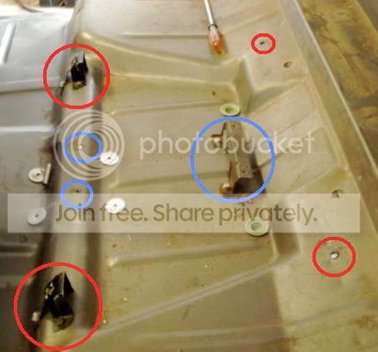

If you get them be sure to get the front mounting tabs that are welded to the floorpan.
I got them, but the tabs on the floor were a no-go. They looked easy enough to fabricate though.
also depends on the year When I've swapped in Buckets I've ALWAYS used Suburban seats and brackets from 81-91 suburbans the picture below is the brackets you need that spot weld to the floor , sorry I dont have any pics of the brackets that bolt to the seat but they are different than Blazers but SHOULD be the same as CrewCabs and 'Burbs because the front floor sections are simular
