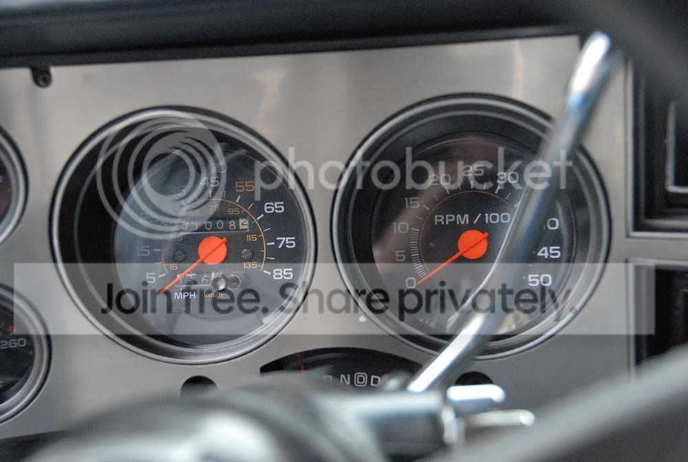

Here is my factory tach in my '89 Blazer.
Well, I finished my tach installation, and I'm very pleased. Thanks for the advice. I do have one issue, however. When the ignition is OFF, the tach reads 1000. When the ignition is ON, it reads accurately at all engine speeds. Is this normal, or have I overlooked something?
Mine stay where the engine was running when the ignition was shut off.
