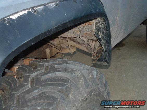

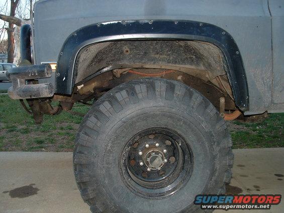

I got bushwacker flares from summitracing.com and they didnt allow much cutting..
fronts allowed 1" front and back of tire (or 2" total) and rear allowed 2" front and back (or 4" total)...

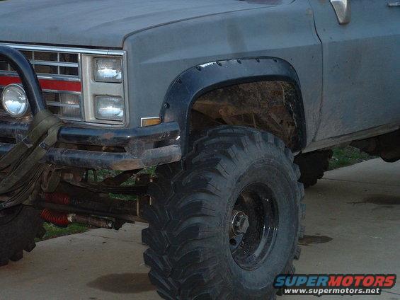

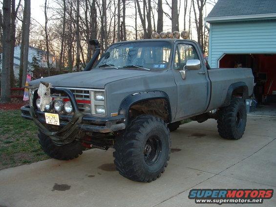

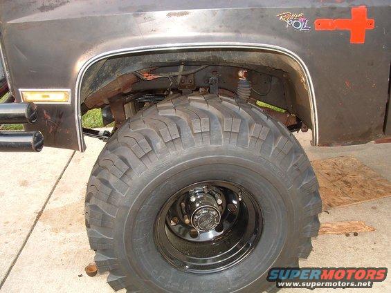

I recentered my rear axle by cutting the wheel well 4" forward and put bushwacker cutout flares on...:wink1:
before:
after:
that is with 6" superlift front leafs and superlift 10" front leafs (with factory block removed lowering the back down to about 7.5"
and the tires are a true 38.8" high (40" hawgs mounted on 16.5x12 rims)
