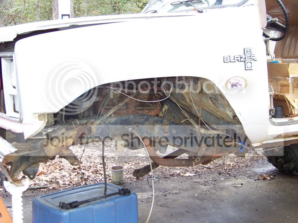

I used an air cutting wheel. Very easy to control and made very clean cuts. Look in my gallery, there are pics there of the trim job. I also posted a full write up in here a while ago.

I prefer the 4.25 on all of it. Just easier to manuver and control. I have since cut off a lil more of the inner fender and beat back the seam on the body. That lil piece at the bottom had cancer so I cut it too. As far as measuring, I just laid a pice of cardboard up there and traced a shape I liked, cut it out and used that piece to trace the line on each side.
