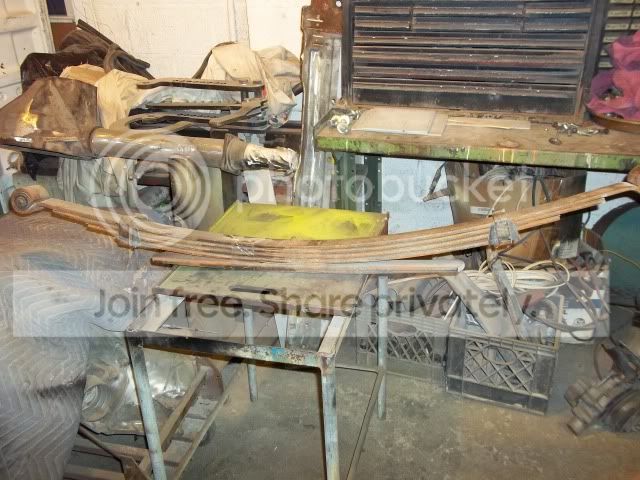

and just to take the "not all 56's are created equal" side... my rear leaves are 56's out of the back of an early 80's 2wd burb...
I expect these to be perfect as is in the back of my rig with the flip..... 5 leaves including the overload... so it should be immune to the issue you may have with front 52 franken packs you hear about prematurely failing...

I run the same rear spring pack Ryoken shows in the picture. 1/2 ton 1986 Suburban springs,56". They flexed too well when I removed the overload leaves so I'm going to put them back in to be better on the street.
I had the spring packs apart and thought I'd try them that way first,too much flex and axle wrap.

I have a 6 leaf pack (that includes the overload) sitting under my truck, now the overload leaf is contoured with the radius of the other leafs, that's probably why its so d*mn stiff. The pic that Ryoken posted has a flat overload so I would suspect that those leafs would be a little softer (that is if they don't have some kind of thorough heat treatment making them more springy).
