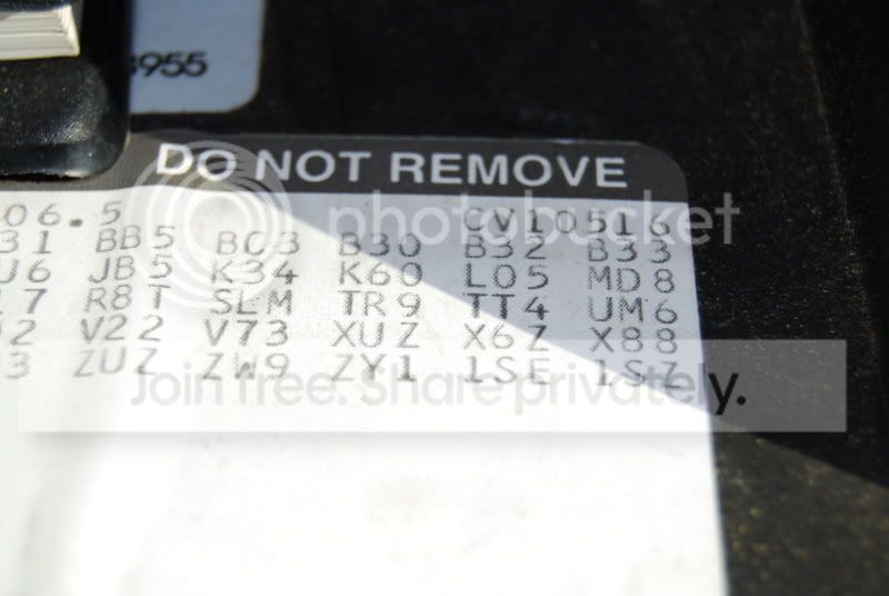

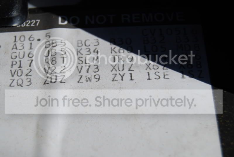

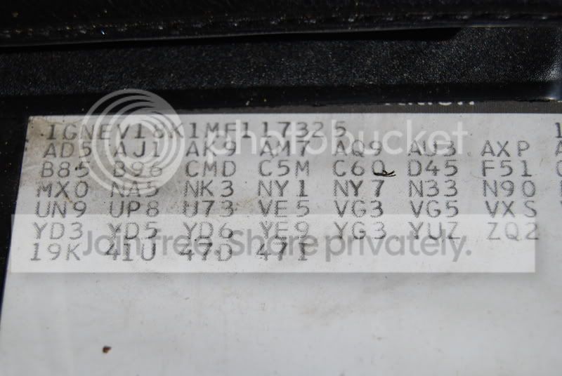

Are these the numbers im looking for??
They'd be better for highway use. You want something like a 4.10 ratio to run 33's with an OD transmission but 3.73's would work as well.
Could be worse, you could have 3.08's or 2.73's.
