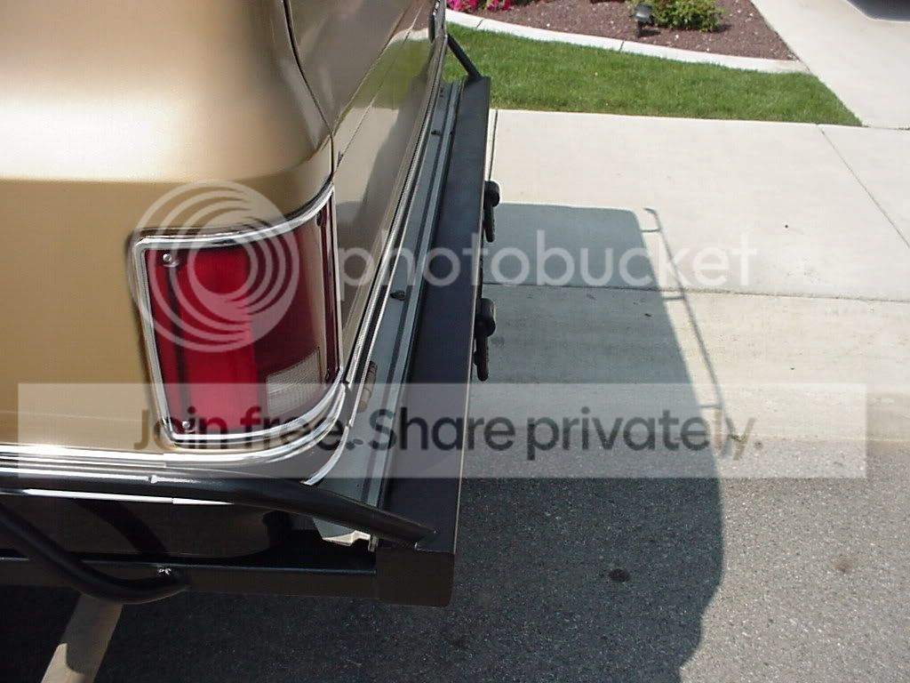

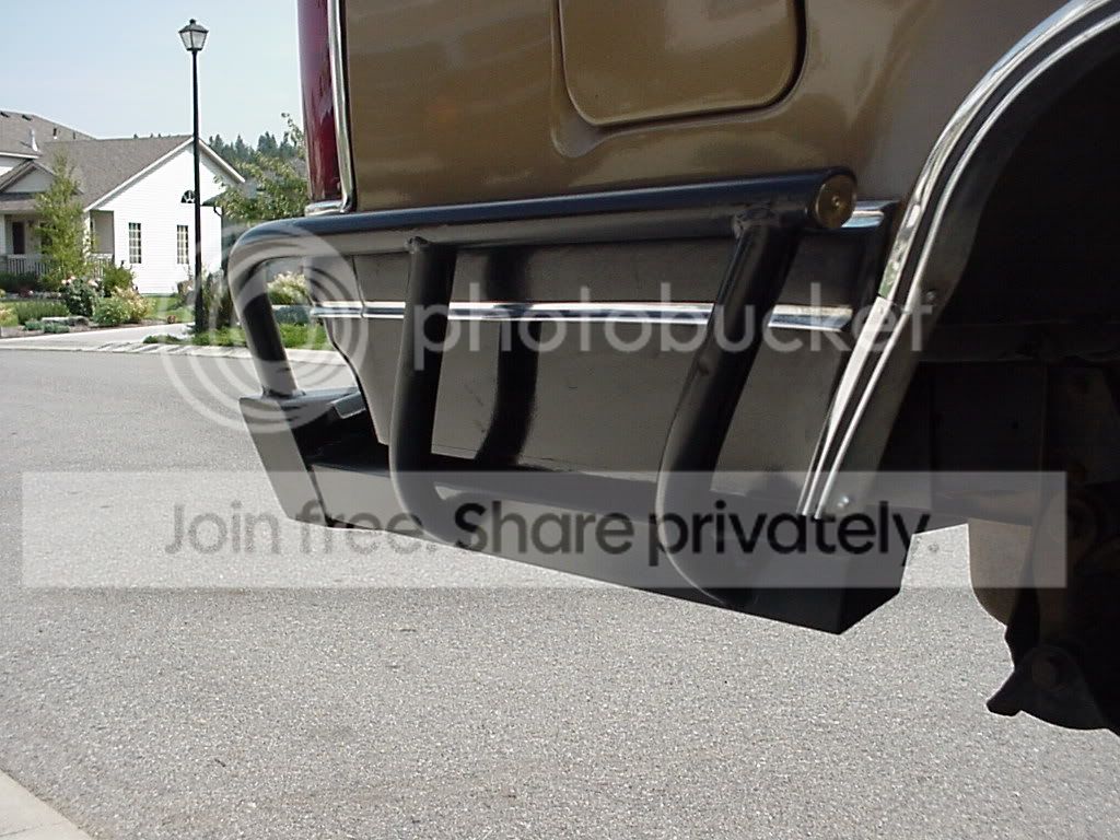

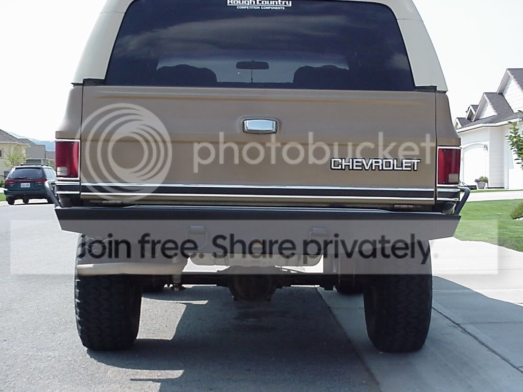

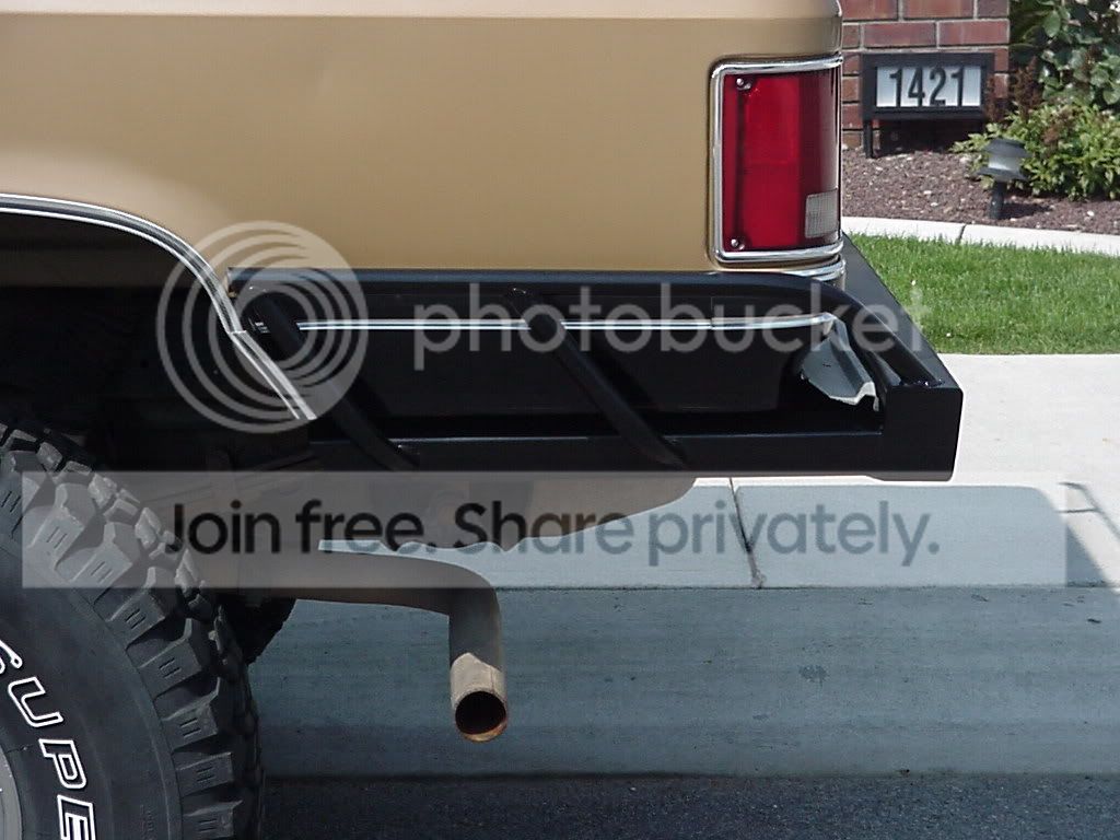

Here she is, as this was the first thing I have ever attempted to build out of metal it took me about three weeks to build but at least I know it is stout /forums/images/graemlins/thumb.gif Hopefully these pics work, they are not the best quality but they will have to do for now.
Oh yeah and thanks to all my fellow Ck5er's for inspireing me to tackle this kind of project /forums/images/graemlins/bow.gif

Wow. That's stout, and clean and simple.

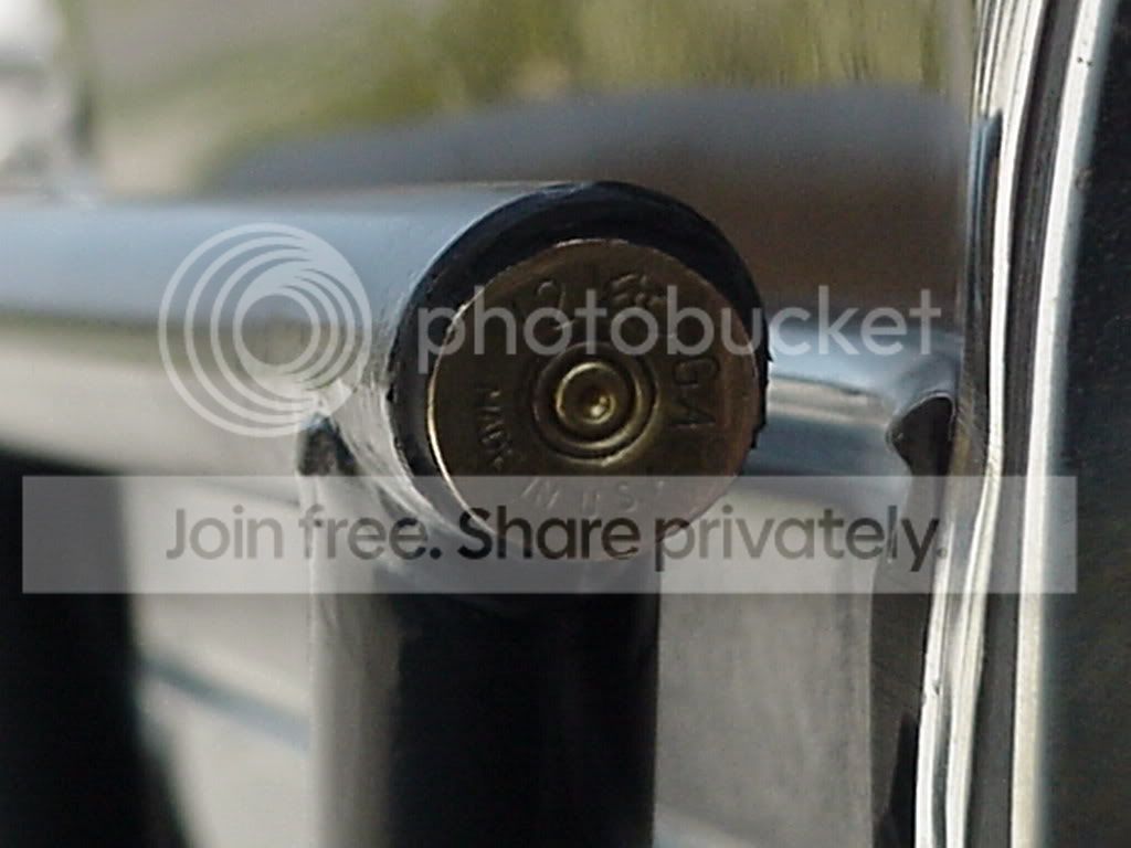

I assume the shells aren't live? /forums/images/graemlins/laugh.gif
[ QUOTE ]
[/ QUOTE ]
No There not, but I thought about it though, lol. I just got tired after working on it forever without alot of tools, and was getting bored of using the grinder to cut out metal to cap off open ends. So I thought that would be fun to do, plus the say made in the U.S.A on them /forums/images/graemlins/thumb.gif
great job, I built my own too and know how much work there is in building one of those...great job.. /forums/images/graemlins/peace.gif
id say that huge chunk of metal on the underside would do the truck /forums/images/graemlins/waytogo.gif
that is a sweeeet bumper /forums/images/graemlins/thumb.gif /forums/images/graemlins/bow.gif
[ QUOTE ]
woah! that looks tuff... do you have reinforments for the sides so they dont get bent in?
[/ QUOTE ]
Come on now do you think I would spend all that time building this and not reinforce the sides? lol. Yeah I angled back rails to reinforce it even though it probably didn't need it.
nice looken /forums/images/graemlins/waytogo.gif

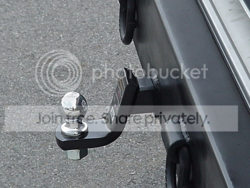

just wondering how far back did you put the hole thin the 2 inch resever?
its a standered hole so if it not the same you might run in to problems hooking up different resevers /forums/images/graemlins/thinking.gif
Nice work! /forums/images/graemlins/thumb.gif
Good to see that the primer was expended on those shells /forums/images/graemlins/yikes.gif/forums/images/graemlins/waytogo.gif

[ QUOTE ]
[/ QUOTE ]
The hole is like 4.5" back. Here is a picture with a reciever, I know just about any Reese brand hitch fits it.
