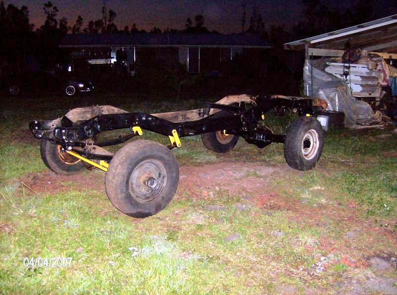

This was the first real step in the rebuild after stripping my old truck down to a bare frame (including removing all the spring hangers). It was a BARE frame. 2 rails and 4 crossmembers, one of which I cut off later!

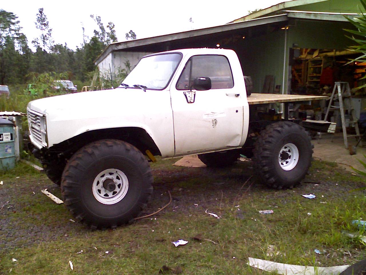

And then all put together. Has all of .5 miles on it at this point!

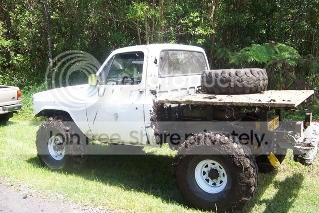

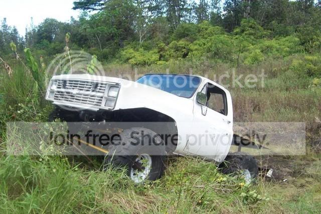

And here it is on it's maiden voyage offroad, through my friend's backyard in hawaii. By the time I drove it around the dirt roads, back and forth to a couple places, then out and wheeled it, it had over 50 miles on it when I put it on the boat to ship it back to the mainland.
