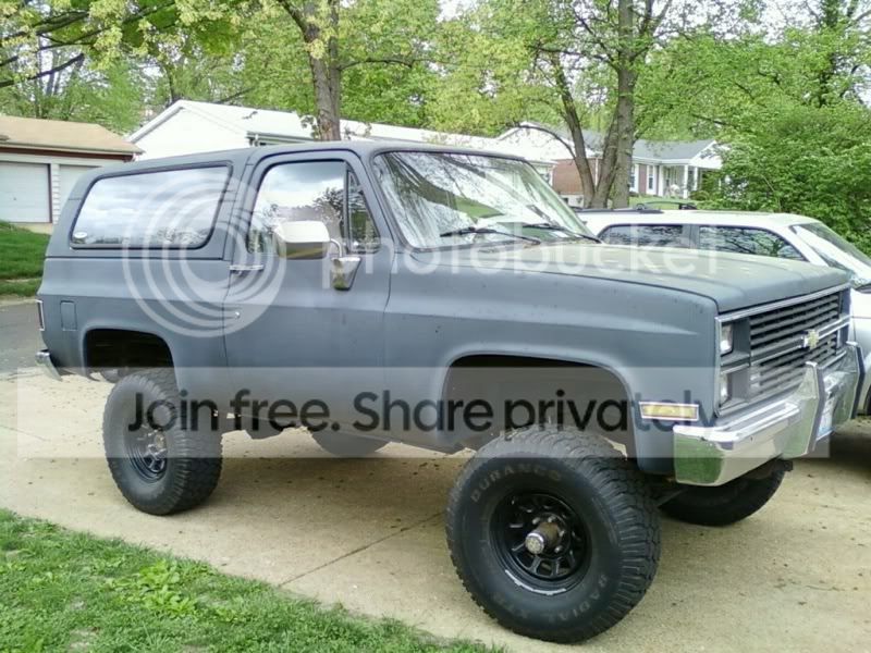

Well I finally scraped up the money, and bought the '85 K5 I've been looking at.
California truck, totally rust free, solid floor pans, solid top to bottom. First time I've ever seen a truck like this here in MO.
Anyway, got into it a little bit today. Took the pink seat covers off today, and found out the seats are pretty much trashed.
Carpet is out, so Herculiner is in the upcoming plans. All the trim is taken apart, but that'll all get put back together.
Anyway, the front axle looks like it might be a D44 or something. It looks nothing like the Corporate 10 bolt that was in my 87 Jimmy. The hubs stick out much further
And the blinkers don't work, so before I can get it road worthy, I've gotta figure out why. When you turn it on, if the brakes are on, the brake light just turns off on that side. I checked the fuse, it's good. The P/O says he thinks its the blinker switch which is located inside the steering column.
Any suggestions?
